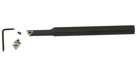

Threading Tool, Internal, 1/2" Indexable HSS Triangle Inserts, A R Warner Kit #20Made in United States
  • For internal threading
  • Includes three T-15 high speed steel TPMW-221 inserts
  • Includes two MS-1153 screws and one T-7 wrench
Part Number: 3571
Weight: 0.67 lb
Price: $134.95
PayPal Credit
This Arthur R. Warner Co. boring bar for single-point cutting internal threads has 0.5" shank and is 6" long.
Approximately 0.55" minimum hole size.
Uses TPMW-221 and TPMW-222 inserts.
The maximum thread depth is 0.100".
