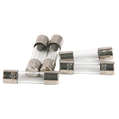

Fuses, 10A 3797 (Discontinued)
- 5 pack 10 amp fuses
- 5 mm x 20 mm
- Used on HiTorque mini mills and mini lathes
- Used on SIEG SX2L and X3 mills and SC2 mini lathes
Part Number: 3797 (Discontinued)
Weight: 0.05 lb
Weight: 0.05 lb
Price: $6.95
5 each, 10 amp, fast-acting fuses. These 5 mm x 20 mm fuses are used on HiTorque mini mills and mini lathes. Also used on SIEG SC2 mini lathes, SX2 mini mills and X2 small mills.
