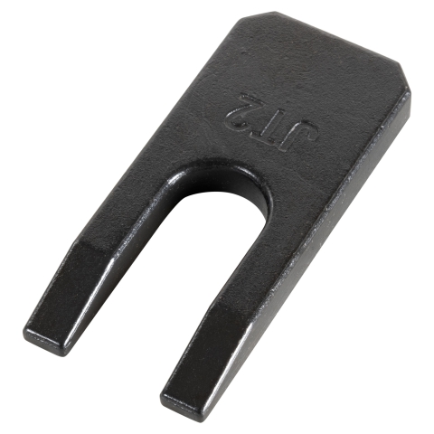

DRILL CHUCK REMOVAL WEDGE SET, JT2
  • Removes taper mount drill chuck from arbor
  • For #2 Jacobs taper
Part Number: 3982
Weight: 0.35 lb
Price: $13.95
Estimated availability:
Unknown
Remove chucks from arbors with these handy wedges. Designed for Jacobs Taper #2 arbors.
2-piece set for removing taper mount chucks from arbors or spindles. These drill chuck removal tools are made to work with your JT2 drill chucks. Thick and durable for reliable performance.
*** IMPORTANT: Please measure the gap between your drill chuck and your arbor to see if your gap is large enough to fit our heavy duty, thick wedges. CONFIRM CORRECT SIZE BEFORE ORDERING.
To remove a chuck from an arbor, insert the wedges between the back of the chuck and the shoulder of the arbor (Illus. C). If the mounting taper of the arbor does not provide a shoulder, drill a cross hole through the neck of the arbor (illus. D.) and insert a cross pin. Then the wedges can be used between the chuck back and the cross pin.
The size of the gap between the drill chuck and arbor for removal will vary depending on the specific chuck and arbor involved. Please confirm the thickness of our wedges will fit in your application before ordering. Choose the right removal tool that matches the taper of your drill chuck for proper fit and functionality.
