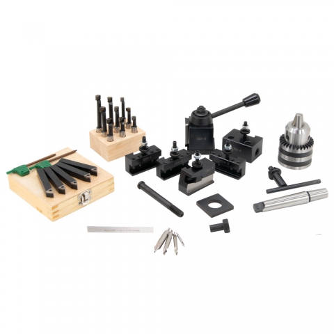

This package contains all the tooling you need to be productive with your G0768, 8x12 or 8x14 lathe on the first day you own it.
The quick change tool post set (QCTP) includes the tool post, mounting hardware, and 5 tool holders. This set includes the tool post and the following tool holders:
2 - #1 Turning and Facing
1 - #2 Boring, Turning and Facing
1 - #4 Heavy Duty Boring will hold both 3/8 and 1/2 boring bars
1 - #7 Universal Parting Blade (for 1/2 inch cut-off blade - 4 degree)
The quick change tool post is a wedge-type made of all steel. No tools are required to change tools. Additional tool holders are available. This tool post mounts on the existing stud. On most 8x12 and 8x14 lathes you must reduce the height of the boss on the top of the compound.
The turning tool holders accept tools with 1/4" to 1/2" shank. The boring tool holder accepts boring bars with up to 3/8" round shanks. The cut-off tool holder holds 1/2" tall parting blades.
The 1/2" capacity drill chuck is mounted on a standard 2 Morse taper shank. The rated capacity of the drill chuck is 1 mm (0.039") to 13 mm (0.512").
The set of indexable turning tools includes 5 tools (TAR, TAL, TBR, TBL, TE), inserts, a wrench, and extra screws. It comes in a wooden case. The carbide inserts are TCMT21.51.
The carbide tipped 9-piece boring bar set includes three different length boring bars each for minimum bores of 5/16", 3/8", and 7/16". The bore depth ranges from 3/4" to 2-1/4". The heat treated, alloy steel shanks are held to 0.000 to -0.0005" from the nominal diameter.
The P1 parting blade is 1/16" x 1/2" x 4-1/2" and made from M2 HSS. These T-shape parting blades provide great side clearance.
This package includes 4 different sizes of combined drills and countersinks, commonly called center drills. The center drill set is high speed steel and includes sizes 1, 2, 3, and 4. These are 60 degree center drills. These are the sizes that are most used by bench top machinists.
This QCTP is not a good fit for the mini lathe. It requires about 3/4" from the top of the compound to the centerline of the lathe. Get the 3112 QCTP instead.
This QCTP is great for most lathes up to 9" swing.
