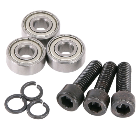

Finger Conversion Kit, Ball Bearing
- Ball bearing conversion kit for brass fingers
- For steady rests and follower rests
- Includes bearings, screws and locking washers
This kit will convert your steady rest to a ball bearing steady rest.

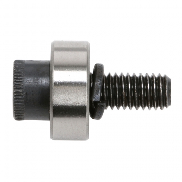

Drill and tap your existing fingers #10-32.
Use an arbor press to push the cap screw through the bearing.
Assemble with the lock washer behind the bearing to provide clearance.
The kit includes three bearings, three cap screws and three lock washers.
Order of Assembly |
Bearing and Fasteners |
| Description | Qty | |
Bearing, R3-ZZ, P/N 2428 | 3 |
Cap Screw, 10-32 x 5/8", Socket Head, P/N 2930 | 3 |
Washer, #10 Lock, P/N 2931 | 3 |
