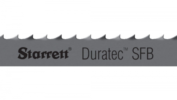

Band Saw Blade, 64-1/2", Duratec SFB 14/S, StarrettMade in United States
  • 14 Teeth per inch
  • For sections 1/4" to 3/4" thick
Part Number: 4462
Weight: 0.21 lb
Price: $13.95
Starrett Duratec SFB band saw blade 64 1/2" x 1/2" x 0.025".
This blade has 14 teeth per inch, for cutting sections over 1/4" to 3/4" thick.
These blades fit the popular 4x6 band saw sold by Harbor Freight, Grizzly and many others.
Made from carbon steel with a flexible back, Duratec SFB is ideal for economical cutting on easy-to-machine ferrous or nonferrous metal, low alloy steel, wood, and plastic. The flexible carbon steel back is ideal for both contour and straight cutting.
