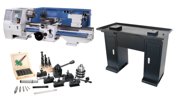

HiTorque Bench Lathe, Tooling Package, and stand. This includes the PN 7500 HiTorque Bench Lathe, the PN 4217 Lathe Tooling Package, and the PN 3973 C4 Stand.
The LittleMachineShop.com HiTorque 8.5x20 Bench Lathe is the best in its class. No other lathes in this size offer power cross feed.
The 1000 Watt brushless spindle drive motor provides tremendous low-end torque. And you can vary the speed from 100 rpm to 2000 rpm continuously in both directions. There are no gears to shift.
The cross feed and compound rest dials are graduated in 0.001" and advance 0.050" per turn. The lathe is equipped with a 4-way indexing tool post set for 10 mm tools.
A reversible 2 mm pitch lead screw provide extended threading capability. You can create every American Standard Unified class 2A inch screw thread from 4 to 80 threads per inch, and you can create every American Standard Metric class 6h thread from 0.2 to 8 mm pitch with the change gears that are included. All the gears on this lathe are metal.
The LittleMachineShop.com model 7500 HiTorque 8.5x20 Bench Lathe is a version of the SIEG SC4 bench lathe.
View a comparison of the specifications for our lathes.
These machines have genuine NSK bearings. Getting genuine bearings in China is not easy as there are so many fakes around. We had SIEG contact the NSK factory to see where to purchase genuine NSK bearings that they could count on as not being fakes.
The HiTorque 8.5x20 Bench Lathes offer extended threading capabilities. Here's a document that explains how to set the change gears on the HiTorque Bench Lathes.
Here are data sheets for the machines that we sell.
Features newly updated for the model 7500 lathe
  • 1000 Watt output spindle motor with spindle speed display
  • Genuine NSK bearings
  • Metal gears
  • Induction hardened ways
  • Power longitudinal feed
  • Power cross feed
  • E-stop safety power switch
  • Spindle on-off button
  • Forward/reverse button for spindle and lead screw direction
  • Reversible lead screw allows for right- and left-hand threading
  • Extended threading capability - inch and metric threads
  • Zero-resettable dials graduated at 0.001" and advancing 0.050" per turn
  • Cam-lock tailstock
  • Four-way tool post
  • 4" (100 mm) 3-jaw self centering lathe chuck
Swing Over Bed 8.5" (215 mm)
Swing Over Saddle 4.6" (118 mm)
Distance Between Centers 16" (410 mm)
Spindle Through Hole 0.8" (20 mm)
Spindle Motor Output 1.34 hp (1000 Watts)
Range of Threads 8-80 TPI (0.2-8.0 mm)
Spindle Taper #3 Morse taper
Tailstock Taper #2 Morse taper
Spindle Speed 100 - 2000 RPM
Cross Slide Travel 3.9" (100 mm)
Power Requirements 120 V 60 Hz 12 Amps
Crated Weight 275 lbs (125 kg)
Machine Weight 207 lbs (94 kg)
Overall Dimensions (W x D x H) 39" x 22" x 16" (1000 mm x 550 mm x 400 mm)
Crate Dimensions (W x D x H) 42" x 28" x 21" (1070 mm x 710 mm x 530 mm)
