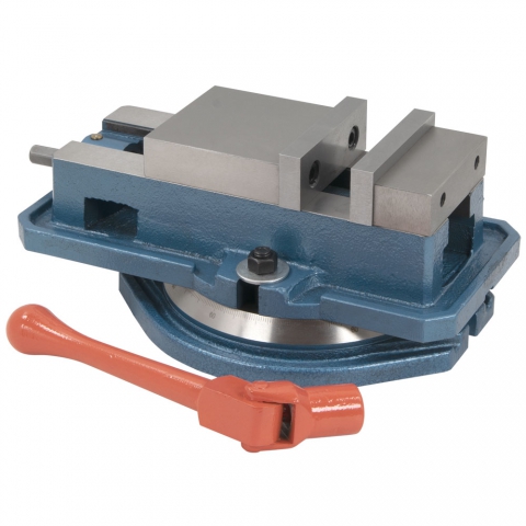

Vise, 4" Precision Milling, Professional Grade
  • Totally enclosed heat treated screw
  • High repeatability and smooth operation
  • Detachable swivel base features easy to read divisions
  • Hardened jaws
Part Number: 4733
Weight: 53.1 lb
Price: $359.95
This is a very well-made precision 4" Kurt-style milling machine vise with a swivel base.
The top, bottom of vise bed, gib, jaws, swivel base, and all plate mounting surfaces are ground.
The jaws are hardened and super precision ground.
The detachable swivel base features easy to read divisions.
The replaceable jaws can be mounted on either end of the fixed and movable jaw supports providing a wide range of clamping distances.
This is our premium vise for the mini mill. It is considerably heavier and therefore more rigid than our next biggest vise.
This vise includes a couple of T-bolts for mounting. But they are way too big for a mini mill, so we recommend our Vise Mounting Kit.
Here's the spec booklet that the factory sends along.
Jaw Width 4.3" (110 mm)
Jaw Depth 1.5" (37 mm)
Maximum Jaw Opening 4.3" (110 mm)
Swivel Base Yes
Weight 50 lbs (23 kg)
Height with Base 5.0" (127 mm)
Height w/o Base 3.5" (90 mm)
Length 12.8" (324 mm)
Width with Base 9.2" (234 mm)
Width w/o Base 6.2" (157 mm)
Hold-Down Mechanism Yes
Ways Parallel to Bottom of Vise Within 0.0003" in 4" (0.008 mm in 100 mm)
Jaws Perpendicular to Ways Within 0.0004" in 4" (0.010 mm in 100 mm)
