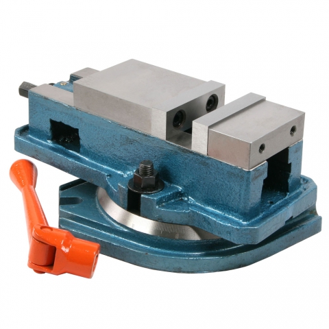

This is a very well-made precision 3" Kurt-style milling machine vise with a swivel base.
The top, bottom of vise bed, gib, jaws, swivel base, and all plate mounting surfaces are ground.
The jaws are hardened and super precision ground.
The detachable swivel base features easy to read divisions.
The replaceable jaws can be mounted on either end of the fixed and movable jaw supports providing a wide range of clamping distances.
This is our premium vise for the mini mill. It is considerably heavier and therefore more rigid than our next biggest vise.
This vise includes a couple of T-bolts for mounting. But they are way too big for a mini mill, so we recommend our Vise Mounting Kit.
