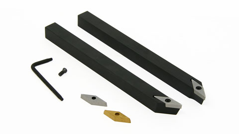

Profiling Tools, 3/8" Indexable R / L, 35 Deg Diamond Inserts, A R Warner Kit #16
- 3/8" Square shank Right Hand profiling tool, 6" overall length
- 3/8" Square shank Left Hand profiling tool, 6" overall length
- Includes 3 HSS (VCMW-221) inserts
- Includes 1 carbide (VCMT-221) insert
- 1 extra MS-1153 Torx screw, 1 T-7 wrench
This profiling tool is great for CNC applications, and can be used for most of your turning needs.
Contents:
1 Right Hand bar 3/8 inch shank, 6 inch overall length, Side angle: 3 degrees
1 Left Hand bar 3/8 inch shank, 6 inch overall length, Side angle: 3 degrees
3 Inserts T-15 High Speed Steel VCMW221, Relief : 7 degrees, IC: 0.250 inch, Thickness: 0.125 inch, Hole: 0.110 inch, Top opening: 0.146 inch, Radius: 0.015 inch
1 Insert Carbide VCMT221, Relief : 7 degree, IC: 0.250 inch, Thickness: 0.125 inch, Hole: 0.110 inch, Top opening: 0.146 inch, Radius: 0.015 inch
Screws: (3) MS-1153
Wrench: T-7
