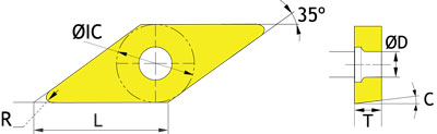

VCMW-221 insert made from T-15 high speed steel, combine the advantages of high speed steel cutting tools with the convenience of indexable tooling.
Insert is a 35° diamond with a 7° relief. The center hole is a 40°-60° single countersink, and there is no chip breaker.
It has an inscribed circle (IC) of 0.25" (1/4"), a thickness of 0.125" (1/8"), and a corner (nose) radius of 0.0156" (1/64").
The insert is designated VCMW221 (ANSI) or VCMW110304 HSS (ISO). For a list of compatible LittleMachineShop.com products, see the Compatibility tab.

insert VCMW-221
Inscribed Circle  ∅ IC 1/4"
Corner Radius R 1/64"
Clearance Angle C
Thickness T 1/8"
Length L 7/16"
Hole / Chip Breaker ∅D 7/64" / none
