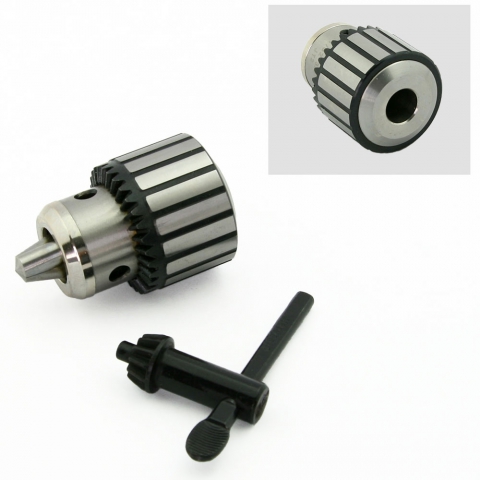

  • 3/8" professional grade drill chuck.
  • Designed for heavy duty jobs
  • Key included
  • Capacity: 1/32" - 3/8"
  • Mounts to 2 Jacobs taper arbor
Part Number: 4862
Weight: 0.80 lb
Price: $26.95
1/32" - 3/8" Capacity professional grade drill chuck. Designed for heavy jobs; all working parts are hardened and manufactured to the highest standards for durability and straight alignment.
This chuck is comparable to a Jacobs 34-33 heavy-duty drill chuck, including the runout specification of 0.004" (0.10 mm) or less. Chuck key is included.
Use a 2MT to 2JT drill chuck arbor to use this chuck with the mini lathe. Use a 3MT to 2JT drill chuck arbor to use this chuck with the mini mill.
Capacity 0.04" - 0.39" (1.0 mm - 10.0 mm)
Maximum Runout 0.004" (0.10 mm)
Mount 2 Jacobs Taper
