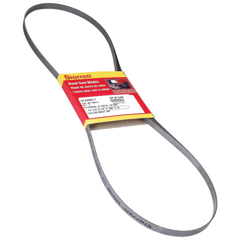

  • 14 Teeth per inch, straight set, zero rake, uniform pitch
  • 44-7/8" (1140 mm) x 1/2" (13 mm) x 0.020" (0.5 mm)
  • Triple tempered M-42 cobalt high speed steel teeth with a fatigue resistant alloy steel backer
  • Patented "Twin Tooth" design of the Split-Chip advantage "bi-metal unique"
  • Faster cutting and longer life than ordinary blades
Part Number: 4933
