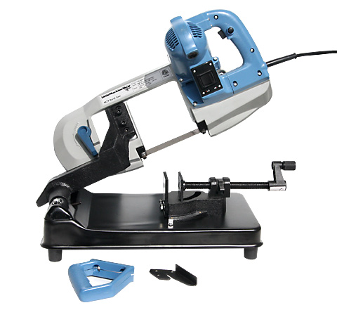

Band Saw, Bench Top
  • Uses widely available 44-7/8" blades
  • Two blade speeds
  • 3" (80 mm) x 4" (100 mm) capacity
  • Comes with a 14 TPI bi-metal blade
  • Includes stand with quick-adjusting cast iron vise
Part Number: 4829  (Discontinued)
Weight: 36.9 lb
Price: $249.95
PayPal Credit
*NOTE* After much consideration we've decided to discontinue this item once our stock is depleted.
They're a good saw for the money, but we just don't feel they're quite up to the standard of quality our customers expect from a Littlemachineshop.com branded machine. The blade has a bit too much flex for a truly straight cut, but work great for rough cuts of bar stock or similar. Small form factor makes changing blades and other repairs, adjustments, etc. a bit tough. We've used one in the shop for years, but honestly just for quick rough cuts and do most precision work on mill/lathe later.
This small bench top band saw is perfect for the small shop. It's got the capacity of larger floor-standing saws but takes a fraction of the space. Cast iron vise swivels for angle cuts. The two-speed motor makes it great for ferrous (read: steel) and non-ferrous (read: aluminum) metals.
It's quieter and more accurate than chop saws. It takes less than 5 minutes to remove the saw from the base and configure it for portable use. The double-chain drive makes this tabletop band saw more rugged than others and the dual ball-bearing blade guides increases accuracy and improves blade life.
Our bench-top band saw has two speeds. Use low speed for steel and other harder materials. Use high speed for aluminum and other non-ferrous metals. High speed works well for wood and plastic, too.
