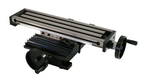

  • 30% more travel in both directions
  • 50% more table area
  • Bolt pattern for solid column attachment (P/N 4307)
Part Number: 5013
Weight: 76.0 lb
$389.95 On Sale
Regularly $469.95
This is a complete X-Y table assembly for a mini mill.
The table is 120 mm (4.73") by 460 mm (18.11"). It has three 12 mm T-slots.
The X-axis travel is 300 mm (11.8") and the Y-axis travel is 130 mm (5.1").
The dials are graduated in 0.001" and one turn of the hand wheels moves the table 0.050".
The X-Y table is made of cast iron and steel. There are adjustable gibs on both axes.
The column mounting bolt pattern consists of 4 M8 threaded holes spaced 135 mm x 50 mm.
