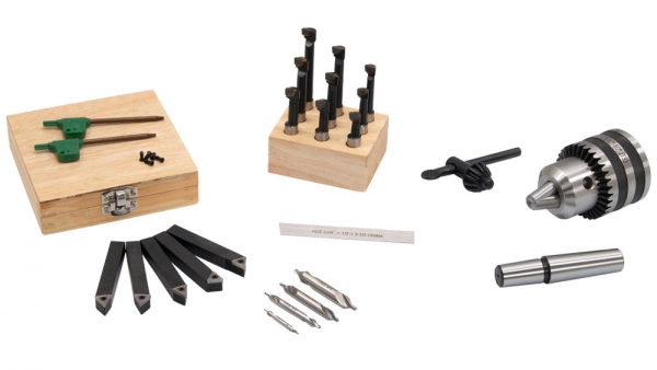

  • 3/8" indexable TCMT inserts
  • 9-piece carbide boring bar set - 3/8" shank
  • 1/2" drill chuck, 2MT short to 33JT drill chuck arbor
  • 4 center drills (sizes 1-4)
  • P1N cut-off blade

This package contains all the tooling you need to be productive with your HiTorque deluxe mini lathe on the first day you own it.
The package does not include a quick change tool post because there is one on the model 4200/5200/7350 lathe.
The 1/2" capacity drill chuck includes a 2 Morse taper shank arbor for the mini lathe. This chuck is specifically designed for the mini lathe tailstock. The rated capacity of the drill chuck is 1 mm (0.039") to 13 mm (0.512").
The set of indexable turning tools includes 5 tools (TAR, TAL, TBR, TBL, TE), inserts, a wrench, and extra screws. It comes in a wooden case. The carbide inserts are TCMT21.51.
The carbide tipped 9-piece boring bar set includes three different length boring bars each for minimum bores of 5/16", 3/8", and 7/16". The bore depth ranges from 3/4" to 2-1/4". The heat treated, alloy steel shanks are held to 0.000 to -0.0005" from the nominal diameter.
The P1 parting blade is 1/16" x 1/2" x 4-1/2" and made from M2 HSS. These T-shape parting blades provide great side clearance.
This package includes 4 different sizes of combined drills and countersinks, commonly called center drills. The center drill set is high speed steel and includes sizes 1, 2, 3, and 4. These are 60 degree center drills. These are the sizes that are most used by bench top machinists.
