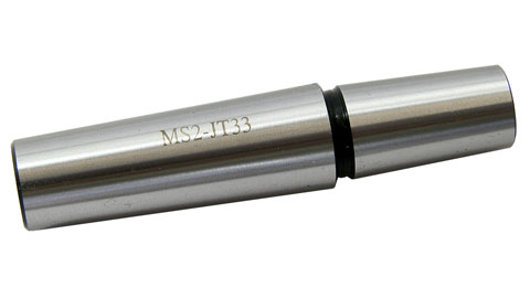

Arbor, Drill Chuck 2MT Short to 33JT
Part Number: 1804
Weight: 0.30 lb
Price: $10.95
Morse taper drill chuck arbor.
2 Morse taper to 33 Jacobs taper. This arbor has a short Morse taper and does not need to be cut to use in the tail stock of the mini lathe.
This product is specifically designed for use on the mini lathe tailstock.
The 2 Morse taper is the correct length for the lathes listed below. Don't buy this product for other lathes as it won't eject from the tailstock when you retract the quill.
If you want this product for a Grizzly G0765 7x14 lathe, put a note on your order: "For a G0765. Need a standard length drill chuck arbor." We will substitute the correct arbor.
This product works with lathes with a short 2 Morse taper tailstock taper including:
  •   SIEG C2 7x12 Mini Lathe
  •   SIEG SC2 7x12 Mini Lathe
  •   SIEG C3 7x14 Mini Lathe
