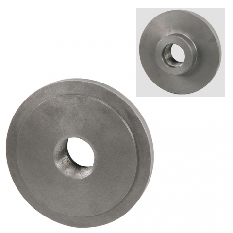

  • Cast iron lathe chuck backplate adapter fits lathes with 1-3/4"-8 spindle nose thread
  • Adapter is 6" (160 mm) in diameter and has no chuck mounting holes
  • Adapter can be used for any 6", 5" or 4" lathe chuck
  • Includes instructions for final turning of the registration diameter to ensure concentricity

*NOTE* These adapters require machining on the lathe on which they will be used.
Instructions are included for final turning of the registration diameter on your lathe to ensure perfect concentricity.
This adapter fits the Grizzly G0602 lathe.
Too many adapters? See our chart that correlates lathe spindle threads to lathe chuck adapters and our chart that provides dimensions of threaded lathe chuck adapters.
These adapters must be machined on your lathe to fit the chuck so that it is concentric on the lathe. In most cases you have to drill the chuck mounting holes also.
We provide complete instructions for mounting the adapter. Our transfer screw sets are the perfect tool for marking the chuck mounting holes on a lathe chuck adapter.
