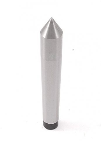

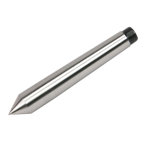

Dead Center, 1MT
- Made of tool steel, hardened and ground
- 60° point
- +/- .0002" TIR
- 0.475" (12.065 mm) diameter
- 3.15" (80 mm) overall length
This center is made from hardened steel and ground for accuracy. The point is a 60º included angle.
The overall diameter is 0.475". The overall length is 3.15".
This product works with lathes with a 1 Morse Taper spindle taper and a 1 Morse taper tailstock taper including:
