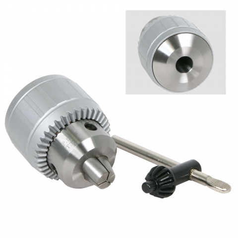

Drill Chuck, 1/2", Ball Bearing
- Capacity: 1/32" - 1/2"
- Taper Mount: 33JT
- +/- .0035" (.0889 mm) TIR
- Ultra smooth with ball bearing
- Chuck key Included
Extra heavy duty, all parts hardened and precision ground. Anti-thrust ball bearing to increase the grip power with high speed drilling.
Chris' TipsUse a 3MT to 33JT drill chuck arbor with the mini mills having a 3 Morse taper spindle.
