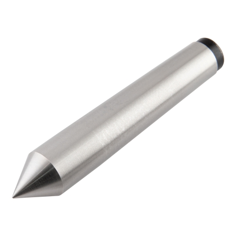

Dead Center, 2MT Standard Length
- Made of tool steel, hardened and ground
- 60 degree point
- +/- .0002" TIR
- 0.7" (17.78 mm) diameter
- 3.94" (100 mm) overall length
This center is made from hardened steel and ground for accuracy. The point is a 60ยบ included angle.
The diameter is 0.7". The overall length is 3.94".
This standard length dead center is for larger mini lathes and bench lathes. The shorter version of this product is designed for the 7x10,12 lathes.
Chris' TipsUse this to turn between centers, using a live center in the tail stock, and a lathe dog to drive the part.
