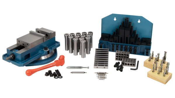

Tooling Package, R8 Bench Mill Premium
  • 4" Precision milling, professional and 10 pairs of thin parallels
  • Thirteen piece R8 collets, 12 piece End Mill Set - 2 & 4 Flute Cobalt (6each)
  • 58 - piece clamping kit - 3/8"-16, 7/16" T-slots
  • Premium precision 1-2-3 blocks, five center drills - 60° countersinks
  • Combination edge and center finder and a T-slot cleaner
Part Number: 5489
Weight: 82.5 lb
$739.95 Value Price
Purchased individually $755.50
Premium tooling package with all the best products for your R8 bench mill.
Milling Vise: 4" Kurt-style professional milling vice with detachable 360 degree swivel base and easy to read divisions. Top, gib, jaws, swivel base, bottom of vise bed and all plate mounting surfaces are ground. The angle tight positive lock style jaws are interchangeable with industry standard machine vises, are hardened and ground, and can be mounted on either end of the fixed and movable jaw supports for a wide range of clamping distances.
Overall length is 11.6" and the height is 3.1" without base, and 4.3" with base. Jaws are 3.15" wide, 0.9" deep, open 3", and are perpendicular to the ways within 0.0004" in 4". The ways are parallel to the base within 0.0003" in 4" without the swivel.
Thin Parallels: Set of ten 4" pairs, 1/8" thick. Made of high-grade alloy steel hardened to 52-58 Rc, parallel within 0.0003" on top and bottom. Parallel heights: 1/2", 5/8", 3/4", 7/8", 1", 1-1/8", 1-1/4", 1-3/8", 1-1/2", and 1-5/8"
End Mills: 12 piece End Mill Set - 2 & 4 Flute Cobalt (6 each).
R8 Collets: 13 R8 round collets sizes 1/8" to 1" by 16ths. Made of high grade tool steel, hardened and ground to a TIR of 0.0005" or less. This set includes all the sizes required for common end mills.
1-2-3 Blocks: Premium precision 1-2-3 blocks, ground and case hardened on all sides to 55-60 Rc. Blocks are 1" x 2" x 3" parallel, flat, and square within 0.0001". Set includes two matched blocks and 5 cap screws. Blocks have 23 holes, five are threaded 3/8"-16 NC.
Center Drills: Five piece M42 8% cobalt combined drills and countersinks sizes 1, 2, 3, 4, and 5 with 60 degree countersinks.
Combined drills and countersinks, commonly called center drills, are used to produce a center hole on a workpiece for turning between centers. Center drills are also used to start drilled holes. Because they are very stiff they don't have a tendency to wander.
Here are the sizes of center drills.
Number Body Dia. Drill Dia. Length
1 1/8" 3/64" 1 1/4"
2 3/16" 5/64" 1 7/8"
3 1/4" 7/64" 2"
4 5/16" 1/8" 2 1/8"
5 7/16" 3/16"  2 3/4"
Nominal Sizes for 7/16" T-Slot Nut
Suitable for 12 mm T-Slot tables on common mini mills.
7/16 inch t slot nut
This product works with mills with a R8 spindle taper and a 0.472 inch T-slot width including:
  •   SIEG X2.7 Bench Mill
  •   SIEG X2.7L Bench Mill
  •   WEN 33075 WEN Bench Mill
  •   SIEG SX2.7 Bench Mill
