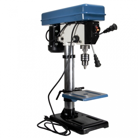

Drill Press, 10" Bench Top, 12-Speed 5530 (Discontinued)
- Bench top drill press
- 10" Swing
- 12 Speeds from 300 to 2900
- #2 Morse taper spindle
- 1/2" Drill chuck
Part Number: 5530 (Discontinued)
Weight: 42.0 lb
Weight: 42.0 lb
Price: $159.95
This is a versatile drill press for the home shop. With 10" swing and 12 speeds it can handle materials from wood, plastic, and most metals, including stainless steel.
The 1/2 horsepower motor lets you drill up to 3/8" holes in steel at one pass.
The 12 spindle speeds are 300, 370, 470, 570, 630, 690, 950, 1400,1620, 1760, 2550, and 2900 RPM.

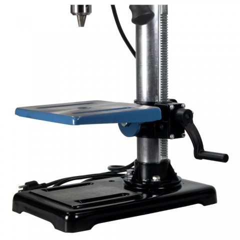

The large table tilts 45 degrees either way and raises and lowers with a rack and pinion.

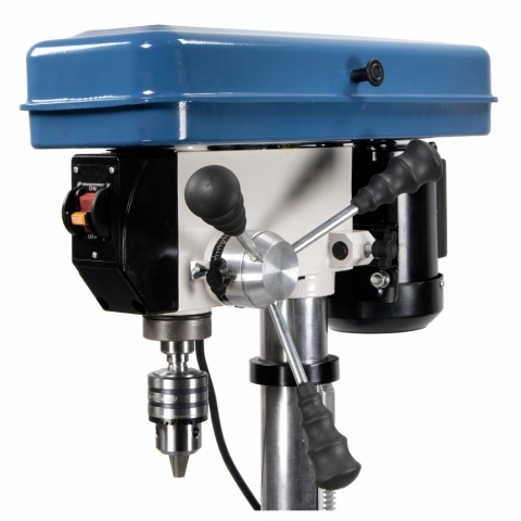

There is an adjustable depth quill stop with a gage.
Included are the drill chuck with key, a drill chuck arbor, and a drift key for chuck removal from the spindle.
Drilling Capacity | 0.37" (9.5 mm) |
Table Size | 7.6" x 7.6" (194 mm x 194 mm) |
Table Tilting Range | 45°-0°-45° |
Quill Travel | 2.4" (60 mm) |
Swing | 9.9" (252 mm) |
Column Diameter | 2.4" (60 mm) |
Maximum Spindle to Table | 10.8" (275 mm) |
Maximum Spindle to Base | 14.8" (375 mm) |
Drill Chuck | 0.12" - 0.51" (3.0 mm - 13.0 mm) |
Spindle Taper | #2 Morse Taper |
Motor | 0.50 hp (375 Watts) |
Spindle Speeds | 12 Speeds 300 - 2900 RPM |
Power Requirements | 120 V 60 Hz 3.75 Amps |
Machine Weight | 37 lbs (17 kg) |
Base Dimensions (W x D) | 8.3" x 13.4" (210 mm x 340 mm) |
Overall Dimensions (W x D x H) | 11.4" x 19.7" x 28.5" (290 mm x 500 mm x 725 mm) |
Crated Weight | 42 lbs (19 kg) |
Carton Dimensions | 21.3" x 17.4" x 9.9" (542 mm x 442 mm x 252 mm) |

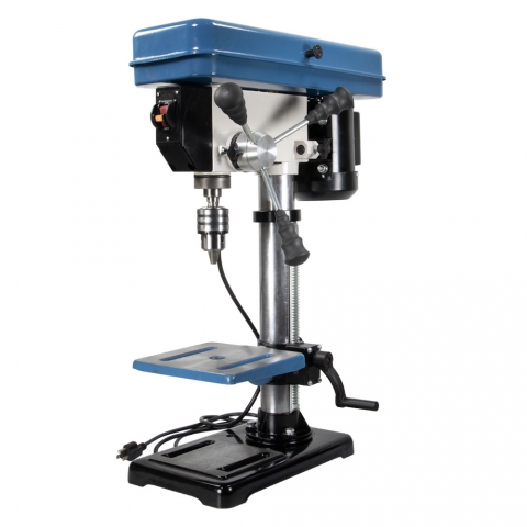

Alternate view |
Top detail |
Bottom detail |
