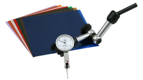

This package includes everything you need to tram your mini mill and square your vise.
Mount the indicator on the universal arm, put the shank of the universal arm in a drill chuck, and check the four corners of your mill table.
Adjust the tram by shimming under the base of the column.
Kit includes LittleMachineShop.com #4304 Shim Stock Assortment, #1249 Dial Test Indicator, and #4653 6" Universal Indicator Arm.
Shim Stock Assortment includes seven sheets of 5"x5" polyester shim stock.
Color coded shim stock sheets are made from a high quality plastic material. Easy to cut and resists oil. Non-magnetic and non-conductive to electricity. Corrosion resistant.
Here are the colors and thicknesses of the items.
- Shim Stock, 0.0005" Silver (mirror like coating)
- Shim Stock, 0.001" Amber
- Shim Stock, 0.0015" Purple
- Shim Stock, 0.002" Red
- Shim Stock, 0.003" Green
- Shim Stock, 0.004" Tan
- Shim Stock, 0.005" Blue
Test dial indicator has 0.0005" graduations, a range of 0-0.030" in either direction, and reading 0-15-0. It includes 5/32" and 3/8" diameter posts, dovetails on the back and end, and a 0.080" diameter point. It comes in a fitted case.
6" universal arm for holding test indicators. Arm is constructed of steel and has a central locking mechanism and fine adjustment knob.
The 3/8" indicator stem hole and dovetail grooves holds most dial indicators and test indicators.
The arm has a 8 mm (0.315") x 40 mm (1.57") unthreaded stem for placing the arm in collets.
