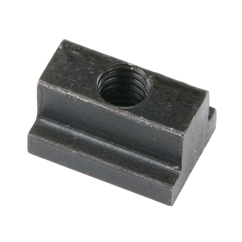

T-Slot Nut, 3/8"
T-Slot Nut, 3/8"
  • Fit 3/8" T-slots
  • Threaded 5/16"-18
  • Black oxide finish
  • Heat treated 1040 steel, case hardened
  • Fits T-slots measuring 0.375" to 0.42" in width
Part Number: 5592
Weight: 0.05 lb
Price: $2.49
These T-slot nuts fit a 3/8" T-slot and are threaded 5/16"-18.
The nuts are the correct size for many mill drills.
They are heat treated and have a black oxide finish.
The stated dimension of the T-slot nut is the width at the top of the T-slot.
Measure the width at the top of the T-slot as shown in the photo below. This is the dimension given for T-slot nuts and clamping kits. For example, if you measure 0.468 at the top of the T-slot, you should get a 7/16” (0.438”) T-slot nut or clamping kit.

Nominal Sizes for 3/8" T-Slot Nut
3/8 inch t slot nut
This product works with mills with a 0.37 to 0.42 inch T-slot width including:
  •   Grizzly G0758 Mill/Drill
  •   BusyBee CX705 Craftex Lathe Mill Combo
  Grizzly G0463 Grizzly Small Mill
Harbor Freight 93885 Central Machinery Small Mill
Various X3-US SIEG Small Mill
Woodstock International M1110 Shop Fox Small Mill
