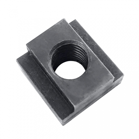

T-Slot Nut, 5/8"
- Fit 5/8" T-slots
- Threaded 1/2"-13 thread
- Black oxide finish
- Heat treated 1040 steel, case hardened
- Fits T-slots measuring 0.62" to 0.7" in width
These T-slot nuts fit a 5/8" T-slot and are threaded 1/2"-13 thread.
They are heat treated and have a black oxide finish.
The stated dimension of the T-slot nut is the width at the top of the T-slot.

Nominal Sizes for 5/8" T-Slot Nut
This product works with mills with a 0.62 to 0.7 inch T-slot width including:
- Harbor Freight 33686 Central Machinery Small Mill
- Rong Fu RF-xx Milling & Drilling Machine
