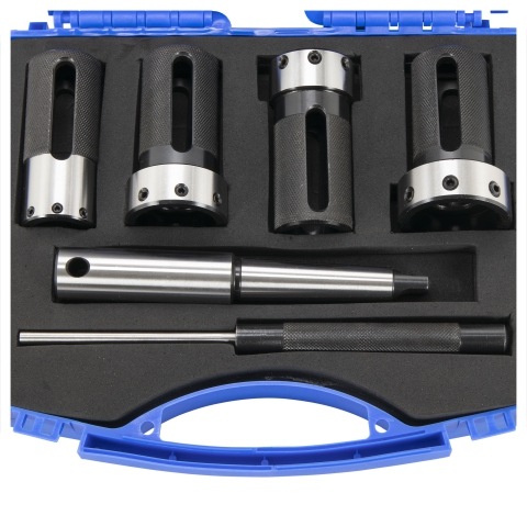

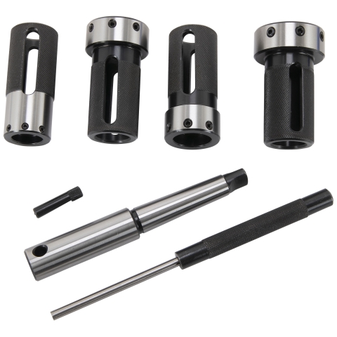

  • The set includes tapered shank, pin punch, and 13/16", 1", 1-5/16" & 1-1/2" die holders
  • 2MT Tang shank
  • Easy to swap out using the provided pin punch.
  • Comes in a fitted case
Part Number: 6155
Weight: 4.57 lb
Price: $49.95
This industrial die holder goes in the tailstock of the mini lathe, or any other lathe with a 2 Morse taper tailstock.
The set includes tapered shank, pin punch, and 13/16", 1", 1-5/16" & 1-1/2" die holders.
