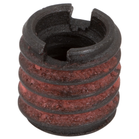

Thread-Locking Insert 1/4"-20 Inside, 3/8"-16 OutsideMade in United States
  • Inside thread is 1/4"-29
  • Outside thread is 3/8"-16
  • Fits the threaded holes in 1-2-3 blocks
  • Fits 7/16" and 1/2" T-slot nuts
Part Number: 6302
Weight: 0.01 lb
Price: $1.95
These inserts reduce at 3/8"-16 threaded hole to a 1/4"-20 threaded hole.
Use them to bolt two 1-2-3 blocks together. Use them to reduce the hole in 7/16" or 1/2" T-slot nuts to 1/4"-20 thread.
These inserts use Loctite® adhesive to keep them in place. The adhesive reaches full strength after 72 hours.
Set the insert with a bolt and two nuts, or use a slotted screwdriver.
These inserts can be used in 1-2-3 blocks so you can screw two 1-2-3 blocks together.
Use them to reduce the thread size of 7/16" and 1/2" T-slots when you need to use 1/4"-20 fasteners to hold things down to the mill table.
Two uses that come to mind are mounting the 5602 or 5604 rotary tables and bolting down a 1-2-3 block as a work stop or square.
