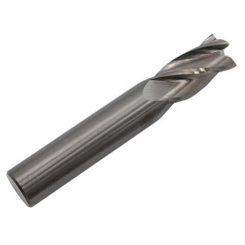

  • Single ended, 4 flute, center cut geometry
  • Designed for increased chip removal rate
  • Used for finishing operation
  • Ideal for milling, slotting, profiling and trace milling
  • Manufactured from premium submicron grain carbide
Part Number: 6337
Weight: 0.27 lb
Price: $39.95
Single end 4 flute center cut end mill made from premium submicron grain carbide. Used for finishing operations. The 4 flute design allows for a high feed rate as less material is removed per flute. Ideal for milling, slotting, profiling and trace milling.
If greater swarf removal is desired, consider one of our 2 flute end mills.
Diameter 1/2"
Flute Length (Loc) 1"
Overall Length 3"
Cutting Diameter Tolerance +.000 / -.002
Shank Diameter Tolerance -.0001 / -.0004
Radius Tolerance +.001 / -.001
Run-Out Tolerance .0005 maximum shank to cutting diameter
