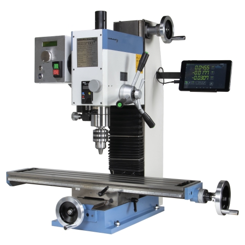

The LittleMachineShop.com HiTorque Deluxe Bench Mill 6550 is the deluxe middleweight in our mill lineup. A significant step up in size, rigidity, and power compared to a mini mill, it is approximately 100 lbs. lighter than our large bench mills. Weighing in at 245 lbs., this mill can be placed on a bench with the help of some friends and its base dimensions of 9.1" x 16.1" will fit on most benches.
The deluxe features added to this HiTorque bench mill include:
- A 3-axis tablet display DRO connected via Bluetooth to magnetic scales on the table and column. The DRO system provides accurate measurement for the X, Y, and Z axis in increments 0.0002" and comes factory installed on the mill.
- Electrically interlocked spindle lock for easy, safe tool changes
- Machined aluminum handwheels
Like our other HiTorque bench mill, the model 6550 has the following standard features:
A 750 Watt (1 hp) brushless DC motor provides abundant spindle power and tremendous low-end torque. The drive allows for spindle speeds from 100 to 2500 RPM continuously in both forward and reverse. A belt drive from motor to spindle eliminates any failure from gears breaking. NSK quality spindle bearings ensure years of quiet operation.
The combination of a large table (27.6" x 6.3") and extensive travel along X, Y, Z-axis (19.7", 5.5", 11.6") provides a large work envelope. Precision ground ways ensure smooth and accurate movement. Adjustable gibs are on all dovetail ways. A fine feed knob on the Z-axis provides for precise control.
The mill has an R8 spindle for wide tool availability. A true quill and drill press-style handles make for easy drilling. Tapping-mode is another standard feature with a button on the end of each handle allowing you to reverse the spindle to make tapping easy.
A digital spindle speed display and a separate digital depth gauge for the quill which reads in inches and mm. You can automatically resume running at the last-used spindle speed. Spindle fine feed and position lock are also standard.
Large anodized handwheels on the X and Y axes and 10 TPI lead screws (accurate to 0.001") provide accurate readings. Ball thrust bearings on feed screws ensure smooth movement.

End Milling Capacity 0.6" (16 mm)
Face Milling Capacity 2.0" (50 mm)
Drilling Capacity 0.8" (20 mm)
Table Size 27.6" x 6.3" (700 mm x 160 mm)
T-Slots 3 slots 0.47" (12.0 mm) wide
X-Axis Travel 19.7" (500 mm)
Y-Axis Travel 5.5" (140 mm)
Z-Axis Travel 11.6" (295 mm)
Throat 7.5" (190 mm)
X- and Y-Axis Feed Screws 0.100" (2.54 mm) per rotation
Quill Travel 2.8" (71 mm)
Maximum Spindle to Table 12.2" (310 mm)
Positioning Accuracy 0.0004" (0.010 mm)
Spindle Taper R8
Spindle Motor 1.01 hp (750 Watts)
Spindle Speed 100 - 2000 RPM
Power Requirements 120 V 60 Hz 10 Amps
Machine Weight 245 lbs (111 kg)
Base Dimensions (W x D) 9.1" x 16.1" (230 mm x 410 mm)
Mounting Holes Center to Center (W x D) 8.27" x 12.01" (210.0 mm x 305.0 mm)
Overall Dimensions (W x D x H) 34.6" x 25.0" x 28.5" (880 mm x 635 mm x 725 mm)
Crated Weight 292 lbs (133 kg)
Crate Dimensions (W x D x H) 36.0" x 28.0" x 35.5" (914 mm x 711 mm x 902 mm)
