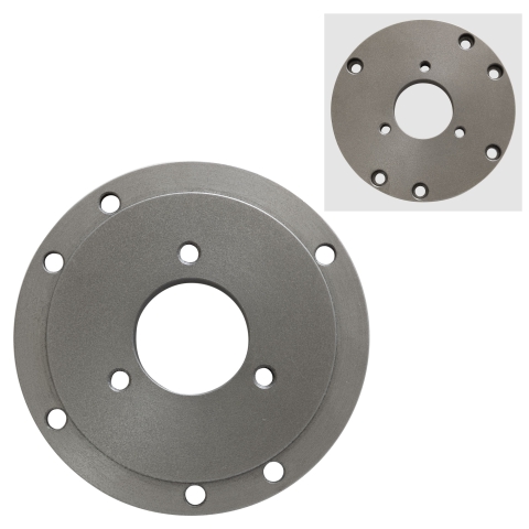

  • Fits 6" 3-Jaw and 4-Jaw Lathe Chucks
  • Designed specifically for the HiTorque 9x20 bench lathe.
Part Number: 6727
Weight: 4.65 lb
Price: $39.95
This adapter mounts to a 6" 3-jaw or 4-jaw lathe chucks with a 3-bolt pattern or 4-bolt pattern and 142mm bolt circle. The adapter has no spindle side registration recess and is designed specifically for the HiTorque 9x20 lathe spindle. It has a 52mm center hole.
Outside Diameter Ø 6.3" (160 mm)
Center Hole Ø 2.0" (52 mm)
Spindle Side Registration Recess None
Spindle Side Bolt Circle Ø 3.0" (75 mm)
Chuck Side Registration Boss Ø 5.1" (130 mm)
Chuck Side Bolt Circle Ø 5.6" (142 mm)
