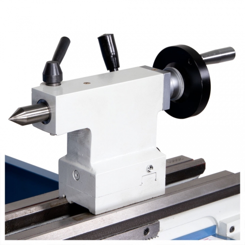

- Cam-lock tailstock

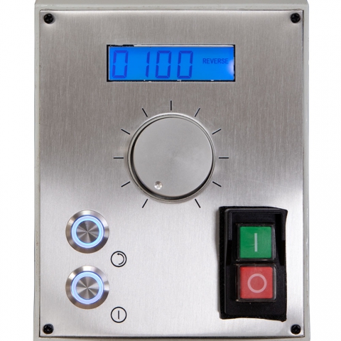

Control panel - forward |
Control panel - reverse |

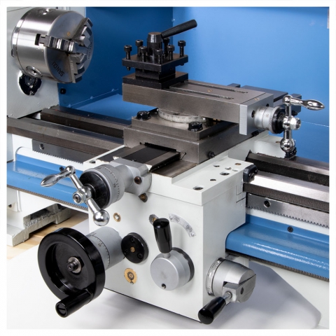

Carriage and compound rest |
Cam lock tailstock |

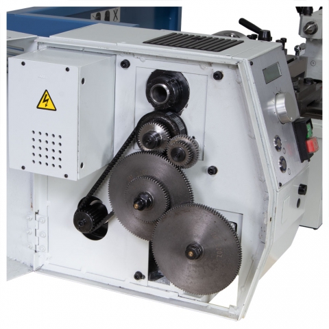

Change gears |

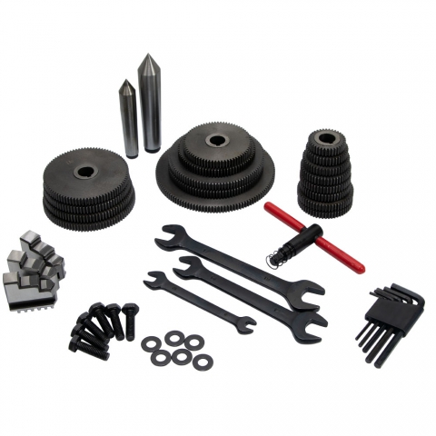

The Bench Lathe comes with the following:
- 4" (100 mm) 3-jaw self centering lathe chuck with two sets of jaws and a chuck wrench
- 4-Way rotating tool post
- A #3 Morse taper dead center for the headstock
- A #2 Morse taper dead center for the tailstock
- Change gear set - 17 Gears - 35, 40, 45, 49, 50 (2), 55, 56, 70, 80, 85, 87, 90, 95, 100 (2), 127 teeth
- Three open end wrenches: 8 x 10 mm, 14 x 17 mm, 17 x 19 mm
- Five hex (Allen) wrenches: 2.5, 3, 4, 5, 6 mm
