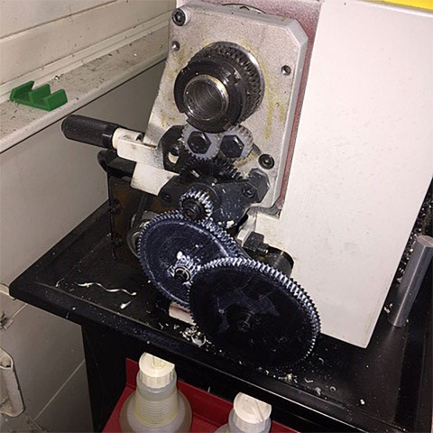

Gear Set, Fine Feed, Mini Lathe
- 80/15 and 90 teeth
- Module 1 Metric gears
- Bore 12 mm
- Keyway 3 mm
- Width 8 mm
This gear set reduces the feed rate for turning from 0.0039" per spindle revolution to 0.0026" per revolution. Slowing the feed rate can help improve the surface finish.
They replace the two 80 tooth gears and the lower 20 tooth gear.
They are 3D printed from PTEG.
Single Gear | |
Gears Installed |
