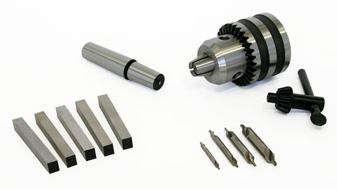

Mini Lathe Starter Kit, 5/16" Tool Bits
  • 0-1/2" Capacity Drill Chuck and key
  • Drill chuck arbor 2MT short to 33JT
  • Five 5/16" M2 high speed steel tool bit blanks
  • Four center drills, sizes 1, 2, 3, and 4
Part Number: 1261
Weight: 3.11 lb
$69.95 Value Price
Purchased individually $77.80
*** Current market conditions are causing us to make substitutions in tooling packages that may not be reflected in the above image. Please check contents tab before ordering.
Mini Lathe starter kit designed for 7x10, 7x12 and 7x14 mini lathes and includes all the basics you need to get started with a new mini lathe.
Drill Chuck: 0-1/2" Capacity drill chuck. All working parts are hardened. Chuck key is included. Number 33 Jacobs taper mount. Runout of this chuck is 0.008" (0.20 mm) or less.
This mini lathe starter kit is specifically designed for use on the mini lathe tailstock. The rated capacity of the drill chuck is 1 mm (0.039") to 13 mm (0.512").
Tool Bits: 5/16" square by 2-1/2" long HSS mini lathe tool bits made of M2 high speed steel. The tool post on most mini lathes are sized to use 5/16" tool bits.
Center Drills: Four sizes combined drills and countersinks made of high speed steel. Sizes 1, 2, 3, and 4 with 60 degree countersinks.
This product is specifically designed for use on the mini lathe tailstock.
The 2 Morse taper is the correct length for the lathes listed below. Don't buy this product for other lathes as it won't eject from the tailstock when you retract the quill.
If you want this product for a Grizzly G0765 7x14 lathe, put a note on your order: "For a G0765. Need a standard length drill chuck arbor." We will substitute the correct arbor.
This kit includes a stub arbor that does not need to be cut off.
We have two lathe starter kits. One starter kit (PN 1261) has 5/16 tool bits which are the correct size for 7x10, 7x12, and 7x14 mini lathes. This kit includes a 2MT short arbor which gives you full use of the tailstock stroke on the mini lathe.
The other starter kit (PN 1796) has 3/8" tool bits which work for most other small lathes. This kit includes a standard 2MT arbor which works in most lathes with a 2MT tailstock taper.
This product works with lathes with a short 2 Morse taper tailstock taper including:
  •   SIEG C2 7x12 Mini Lathe
  •   SIEG SC2 7x12 Mini Lathe
  •   SIEG C3 7x14 Mini Lathe
