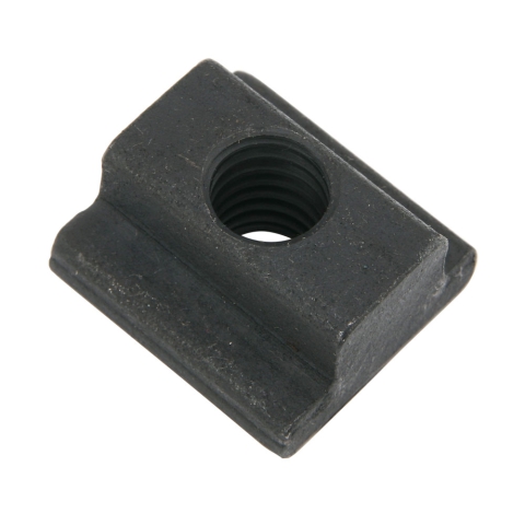

T-Slot Nut, 1/2"
T-Slot Nut, 1/2"
  • Fits 1/2" T-slots
  • Threaded 3/8"-16
  • Black oxide finish
  • Heat treated 1040 steel, case hardened
  • Fits T-slots measuring 0.5" to 0.6" in width
Part Number: 2021
Weight: 0.05 lb
Price: $2.49
These T-slot nuts fit a 1/2" T-slot and are threaded 3/8"-16.
The nuts are the correct size for many mill drills.
They are heat treated and have a black oxide finish.
The stated dimension of the T-slot nut is the width at the top of the T-slot.
Measure the width at the top of the T-slot as shown in the photo below. This is the dimension given for T-slot nuts and clamping kits. For example, if you measure 0.468 at the top of the T-slot, you should get a 7/16” (0.438”) T-slot nut or clamping kit.

Nominal Sizes for 1/2" T-Slot Nut
1/2 inch t slot nut
This product works with mills with a 0.5 to 0.6 inch T-slot width including:
  •   Grizzly G0720 Bench Mill
  •   Grizzly G0720R Bench Mill
  •   Grizzly G0722 Bench Mill
  •   SIEG SX4 Bench Mill
