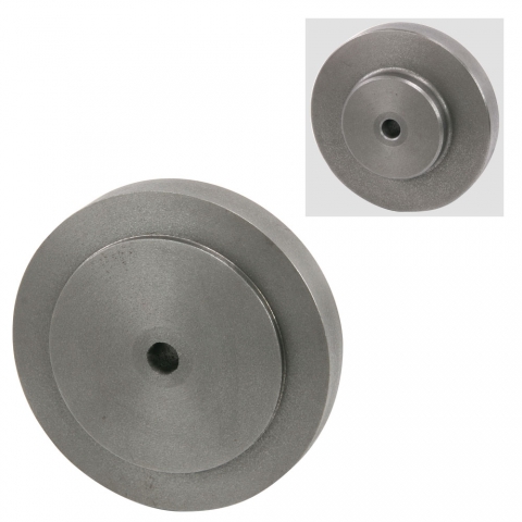

Chuck Adapter, Unthreaded 4" Diameter
  • Cast Iron Adapter Can Be Threaded to Fit Any Spindle Nose Thread
  • 3/8" Smooth Pilot Hole
  • 4" (100 mm) in Diameter and Has No Chuck Mounting Holes
  • Use It for All 3" and 4" Chucks
  • 55 mm Diameter Hub
Part Number: 2335
Weight: 2.97 lb
Price: $39.95
Cast iron lathe chuck adapter can be threaded to fit any spindle nose thread. It has a 3/8" smooth pilot hole. This adapter is 4" (100 mm) in diameter and has no chuck mounting holes. Use it for all 3" and 4" chucks.
*NOTE* These adapters require machining on the lathe on which they will be used.
Instructions are included for final turning of the registration diameter on your lathe to ensure perfect concentricity.
Too many adapters? See our chart that correlates lathe spindle threads to lathe chuck adapters and our chart that provides dimensions of threaded lathe chuck adapters.
These adapters must be machined on your lathe to fit the chuck so that it is concentric on the lathe. In most cases you have to drill the chuck mounting holes also.
We provide complete instructions for mounting the adapter. Our transfer screw sets are the perfect tool for marking the chuck mounting holes on a lathe chuck adapter.
WOODWORKERS: Our threaded adapters are not suitable for use on wood turning lathes. Please do not purchase them for this application. These adapters require machining on the lathe on which they will be used, and this is impossible on a wood lathe.
Nominal Size 4"
Outside Diameter Ø 3.9" (100 mm)
Thread 10 mm Smooth Bore
Bolt Holes None
Hub Diameter Ø 2.2" (56 mm)
Hub Length Ø 0.9" (24 mm)
Flange Thickness Ø 0.6" (16 mm)
Registration Boss Ø 0.1" (3 mm)
Registration Diameter Ø 2.8" (72 mm)
