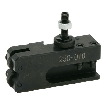

Quick Change Knurling & Turning Tool Holder, 0XA
- Tool Bit Capacity of Up to 1/2"
- Hardened and Ground
- Compatible with 0XA, or Series 000, Tool Post
Knurling, turning, and facing tool holder for 0XA, or series 000, quick change tool posts.
This tool has knurling rolls at one end, and holds a turning or facing tool on the other end.
Holds tools with up to 1/2" square shanks
This tool holder has 250-010 on it.
