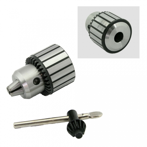

Drill Chuck, 1/2" Professional Grade
- Precision made for reduced runout
- Designed for heavy duty jobs
- Key included
- Capacity: 1/32" - 1/2"
- Mounts to 33 Jacobs taper arbor
1/32" - 1/2" Capacity professional grade drill chuck. Designed for heavy jobs; all working parts are hardened and manufactured to the highest standards for durability and straight alignment.
This chuck is comparable to a Jacobs 34-33 heavy-duty drill chuck, including the runout specification of 0.004" (0.10 mm) or less. Chuck key is included.
Chris' TipsUse a 3MT to 33JT drill chuck arbor with the mini mills having a 3 Morse taper spindle.
| Capacity | 0.04" - 0.51" (1.0 mm - 13.0 mm) |
| Maximum Runout | 0.004" (0.10 mm) |
| Mount | 33 Jacobs taper |
