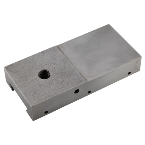

- Compound rest top
- Mount AXA quick change tool post to SIEG C6/SC6 lathes
- Fits Grizzly G0516 Combo Lathe
- Threaded 9/16"-18
Part Number: 3787
Weight: 2.40 lb
Weight: 2.40 lb
$29.95
Regularly $39.95
Estimated availability:
16-Apr-2024
This compound rest top is specially modified to mount the AXA quick change tool post on a SIEG C6/SC6 or Grizzly G0516 lathe.
The two tapped holes that secure the feed screw retainer must be match drilled and tapped in this part. Things come this way from the factory when they do the process during assembly. I'm sure they do it with a hand-held drill.
Overall Length | 5.31" (135.0 mm) |
Length Raised Section | 2.48" (63.0 mm) |
Width | 2.56" (65.0 mm) |
Height | 0.91" (23.0 mm) |
Bottom Dovetail Narrowest Point | 1.26" (32.0 mm) |
Bottom Dovetail Widest Point | 1.57" (40.0 mm) |
