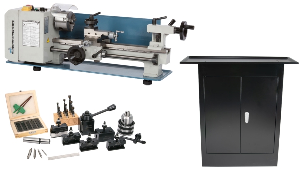

This bundle includes the PN 5100 HiTorque Mini Lathe and the 5207 tooling package.
The LittleMachineShop.com HiTorque Mini Lathe is the best in its class. It has the most power, most torque, and a longer center distance than other lathes in its class.
The 500 Watt brushless spindle drive motor provides tremendous low-end torque. And you can vary the speed from 50 rpm to 2500 rpm continuously in both directions. There are no gears to shift.
The cross feed and compound rest dials are graduated in 0.001" and 0.025 mm.
Real top and bottom half-nuts and a reversible 16 TPI lead screw provide extended threading capability. You can create every American Standard Unified class 2A inch screw thread from 4 to 80 threads per inch, and you can create every American Standard Metric class 6h thread from 0.3 to 8 mm pitch with the extra 21 tooth change gear that is included.
The lathe includes a chip tray, a backsplash guard, and spreaders to give the feet a broader stance.
The LittleMachineShop.com model 5100 HiTorque Mini Lathe is a version of the SIEG SC2.
The Premium Tooling Package includes a high-quality all-steel wedge-style quick change tool post set with five tool holders, a 1/2" professional-grade drill chuck on a 2 Morse taper shank, American-made indexable turning tools, an indexable boring bar, a premium cut-off blade, and center drills.
