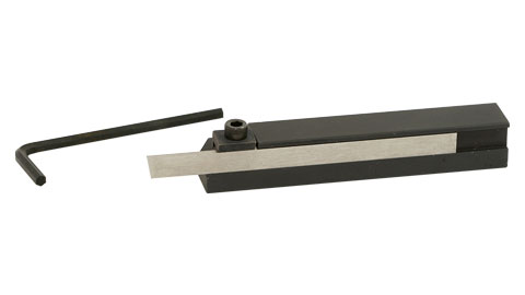

  • For external grooving and cut-off operations
  • Includes one 1/2" shank holder 3" overall length
  • Includes one 0.062" cut-off blade T-15 high speed steel
  • Blade is 7/32" (0.218") tall and 3" long
  • Includes One 7/64" Allen wrench
Part Number: 5130
Weight: 0.61 lb
Price: $124.95
PayPal Credit
1/2" shank high speed steel grooving and cut-off tool for external grooving and cut-off operations. Includes one 1/2" shank holder which is 3 inches in length.
Also includes one 1/16" thick cut-off blade made of T-15 high speed steel.
The blade is 7/16" (0.218") tall and 3" long.
Made in the US by the Arthur R. Warner Co. The Arthur R. Warner Co. is a family-owned American manufacturer of high speed steel products with specialization in cutting, shaping, pre-grinding, heat treating, and finish grinding of premium grades of flat high speed steel. Their quality is excellent and LittleMachineShop.com is proud to carry their products.
