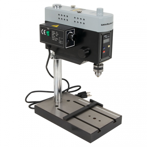

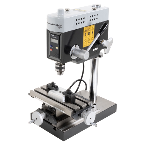

Alternate View |
Shown with X-Y Table Assembly and 8mm clamping kit (not included) |

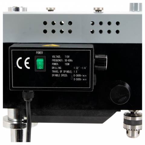

Side View, Power Switch |

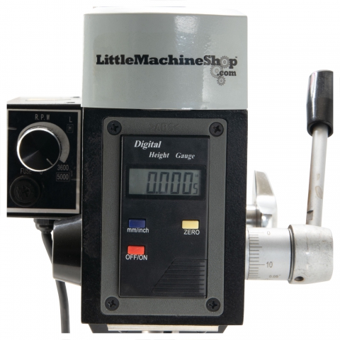

Ditigal Height Gauge and Speed Dial |

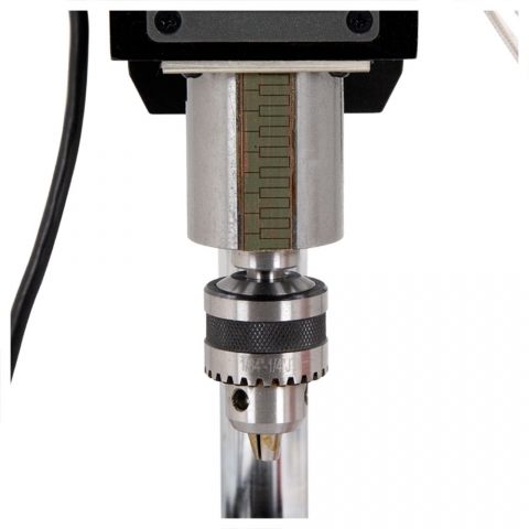

Quill and Chuck |

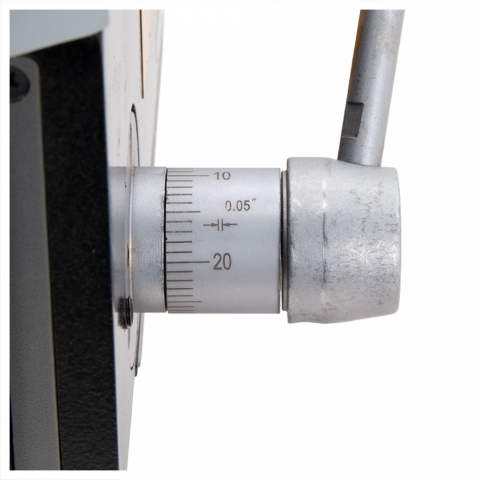

Z-Axis Dial |
Speed Dial |

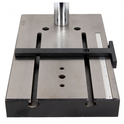

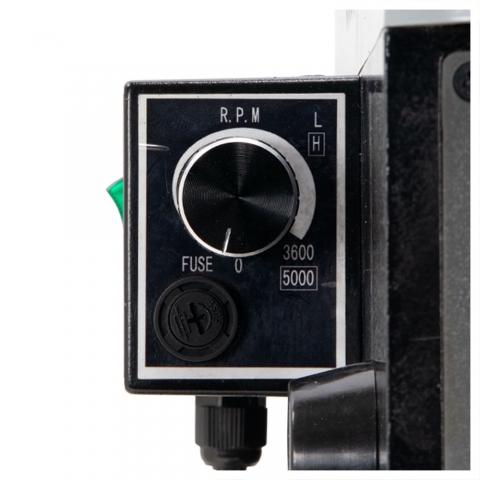

Base |

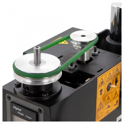

Belt in High RPM Position |

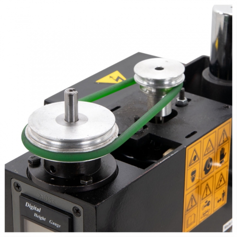

Belt in Low RPM Position |

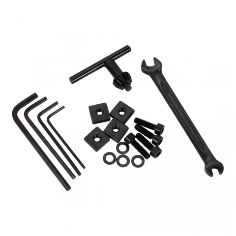

Included Tools |
