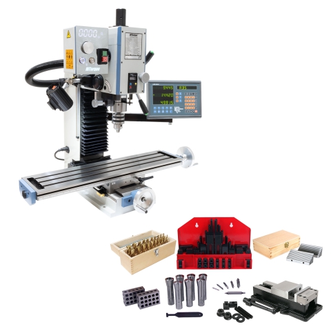

This bundle includes the 6570 HiTorque Deluxe Long Table Bench Mill and the 3526 Bench Mill Tooling Package.
The LittleMachineShop.com HiTorque Deluxe Bench Mill 6570 is the deluxe middleweight in our mill lineup. A significant step up in size, rigidity, and power compared to a mini mill, it is approximately 100 lbs. lighter than our large bench mills. Weighing in at 245 lbs., this mill can be placed on a bench with the help of some friends and its base dimensions of 9.1" x 16.1" will fit on most benches.
The deluxe features added to this HiTorque bench mill include:
- Factory installed, hard wired 3-axis DRO with easy to read display. Magnetic scales are mounted on the table and column. The DRO system provides accurate measurement for the X, Y, and Z axis in increments 0.0002".
- Electrically interlocked spindle lock for easy, safe tool changes
- Machined aluminum handwheels
Like our other HiTorque bench mill, the model 6550 has the following standard features:
A 750 Watt (1 hp) brushless DC motor provides abundant spindle power and tremendous low-end torque. The drive allows for spindle speeds from 100 to 2000 RPM continuously in both forward and reverse. A belt drive from motor to spindle eliminates any failure from gears breaking. NSK quality spindle bearings ensure years of quiet operation.
The combination of a large table (27.6" x 6.3") and extensive travel along X, Y, Z-axis (19.7", 5.5", 11.6") provides a large work envelope. Precision ground ways ensure smooth and accurate movement. Adjustable gibs are on all dovetail ways. A fine feed knob on the Z-axis provides for precise control.
The mill has an R8 spindle for wide tool availability. A true quill and drill press-style handles make for easy drilling. Tapping-mode is another standard feature with a button on the end of each handle allowing you to reverse the spindle to make tapping easy.
A digital spindle speed display and a separate digital depth gauge for the quill which reads in inches and mm. You can automatically resume running at the last-used spindle speed. Spindle fine feed and position lock are also standard.
Large anodized handwheels on the X and Y axes and 10 TPI lead screws (accurate to 0.001") provide accurate readings. Ball thrust bearings on feed screws ensure smooth movement.
At LittleMachineShop.com, we stand behind every machine we sell! If it’s not right, we’ll make it right and we have the in-house technicians and replacement parts in our U.S. warehouse to back it up.
This mill is a version of the SIEG SX2.7 built to LittleMachineShop.com specifications.
Here is the Users Manual for the DRO display unit.
You can compare the specifications for our mills.
  • 750 Watt (1 hp) brushless DC spindle drive
  • R8 Spindle for wide tool availability
  • Electrically interlocked spindle lock
  • Japanese quality bearings (NSK or equivalent)
  • No gears in spindle drive
  • 0.001" Graduated dials, 0.100" per turn
  • Factory installed 3-axis DRO display and Magnetic scales
  • Digital position readout on the quill reads in inches and mm
  • Large X-Y table with machined aluminum handwheels
  • Tapping mode for reversing taps out
  • Solid rectangular column for rigidity
  • Dovetail column maintains head alignment at any height
  • E-stop safety power switch
  • Forward and Reverse modes on the power panel
  • Spindle speed display
  • Spindle fine feed and position lock
  • Fine feed on Z-axis for precise control
  • Adjustable gibs on all dovetail ways
  • Includes R8 to 33JT drill chuck arbor and drill chuck
End Milling Capacity 0.6" (16 mm)
Face Milling Capacity 2.0" (50 mm)
Drilling Capacity 0.8" (20 mm)
Table Size 27.6" x 6.3" (700 mm x 160 mm)
T-Slots 3 slots 0.47" (12.0 mm) wide
X-Axis Travel 19.7" (500 mm)
Y-Axis Travel 5.5" (140 mm)
Z-Axis Travel 11.6" (295 mm)
Throat 7.5" (190 mm)
X- and Y-Axis Feed Screws 0.100" (2.54 mm) per rotation
Quill Travel 2.8" (71 mm)
Maximum Spindle to Table 12.2" (310 mm)
Positioning Accuracy 0.0004" (0.010 mm)
Spindle Taper R8
Spindle Motor 1.01 hp (750 Watts)
Spindle Speed 100 - 2000 RPM
Power Requirements 120 V 60 Hz 10 Amps
Machine Weight 245 lbs (111 kg)
Base Dimensions (W x D) 9.1" x 16.1" (230 mm x 410 mm)
Mounting Holes Center to Center (W x D) 8.27" x 12.01" (210.0 mm x 305.0 mm)
Overall Dimensions (W x D x H) 34.6" x 25.0" x 28.5" (880 mm x 635 mm x 725 mm)
Crated Weight 292 lbs (133 kg)
Crate Dimensions (W x D x H) 36.0" x 28.0" x 350.1" (914 mm x 711 mm x 8891 mm)
HiTorque Bench Mill Front View
"HiTorque Bench Mill Control Panel
"HiTorque Bench Mill Z-Axis Handle and Spindle
"HiTorque Bench Mill X-Axis Aluminum Hand Wheel
"HiTorque Bench Mill Y-Axis Aluminum Hand Wheel
"HiTorque Bench Mill Z-Axis Aluminum Hand Wheel
"HiTorque Bench Mill Mounted LED Light
"HiTorque Bench Mill Mounted LED Light Side View
"HiTorque Bench Mill Digital Height Gauge
"HiTorque Bench Mill X-Axis DRO Scale and Reader
"HiTorque Bench Mill Y-Axis DRO Scale and Reader
"HiTorque Bench Mill Z-Axis DRO Scale and Reader
"HiTorque Bench Mill Tools Included
