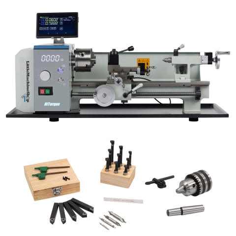

HiTorque Deluxe Mini Lathe with LED display and tooling package.
This package includes the newest HiTorque mini lathe, model 7450, the 5124 tooling package
The 7450 Deluxe mini lathe is has an LED mirror display which clearly and elegantly organizes the key controls for the lathe. All controls are Illuminated, and it includes a start/stop button, a spindle direction button and emergency power (E-stop) switch. A variable speed control knob allows accurate control of spindle speeds, while an integrated spindle speed display clearly displays the speed.
The 7450 lathe also comes equipped with a 2-axis tablet display DRO connected via Bluetooth to magnetic scales on the longitudinal and cross feeds. It also has 2 digital readouts on the compound rest and tailstock. The DRO system measures in increments .0002" and comes factory installed on the lathe.
A 500-Watt brushless spindle drive motor and belt drive provides tremendous power and low-end torque. There are NO gears to shift, so no gears to break. The drive allows for spindle speeds from 100 to 2500 RPM continuously in both directions. NSK brand Japanese-quality spindle bearings ensure smooth and quiet operation.
Standard on the lathe is an all steel, wedge-type quick change tool post which accepts turning tools up to 1/2" shank. Five toolholders are also included for the most common tools and tasks. The lathe also comes with a 4" Sanou lathe chuck, a Morse taper #2 dead center for the tailstock, and an 11-gear change gear set that includes a 21-tooth gear for accurate metric threading. For more details, see the Contents tab.
Real top and bottom half-nuts with a 16 TPI lead screw and a factory-installed threading dial provide extended threading capability. You can create every American Standard Unified class 2A inch screw thread from 4 to 80 threads per inch, and you can create every American Standard Metric class 6h thread from 0.3 to 8 mm pitch with the extra 21 tooth change gear that is included.
The 7x16 lathe includes attractive aluminum hand wheels and chrome levers. A backsplash guard and deluxe chip tray with rubber feet give a broader and more secure stance.
The 5124 tooling package comes equipped with a 2MT short arbor for the tailstock, a boring bar set, center drills, cut-off blade, 1/2" drill chuck and a set of turning tools with indexable inserts.

  • LED display with illuminated controls and integrated spindle speed readout
  • Factory installed 2-axis DRO with 7" Android tablet readout on cariage and cross feed
  • Digital readouts on the compound rest and tailstock quill
  • NSK brand Japanese bearings
  • No gears in spindle drive
  • Aluminum hand wheels
  • Chrome levers
  • Cam lock tailstock with DRO
  • E-stop safety power switch
  • Extended threading capability - inch and metric threads
  • Integrated Threading dial
  • Reversible lead screw for right and left hand threads
  • 0XA wedge-type Quick change tool post set with five tool holders
  • 4" 3-jaw SANOU chuck
  • Rear apron shield to keep swarf out of the mechanism
  • Heavy duty chip tray with wide stance rubber feet for added stability
  • Mini Lathe Users Guide
Swing Over Bed 7.1" (180 mm)
Swing Over Saddle 4.3" (110 mm)
Distance Between Centers 16" (410 mm)
Cross Slide Travel 2.6" (65 mm)
Spindle Through Hole 0.8" (20 mm)
Spindle Taper #3 Morse taper
Tailstock Taper #2 Morse taper
Range of Threads 4-80 TPI; 0.3-8.0 mm
Spindle Motor Output 0.67 hp (500 Watts)
Spindle Speed 100 - 2500 RPM
Machine Weight 108 lbs (49 kg)
Crated Weight 143 lbs (65 kg)
Overall Dimensions (W x D x H) 31" x 10" x 12" (790 mm x 260 mm x 300 mm)
Crate Dimensions (W x D x H) 36" x 17" x 18" (920 mm x 440 mm x 465 mm)
