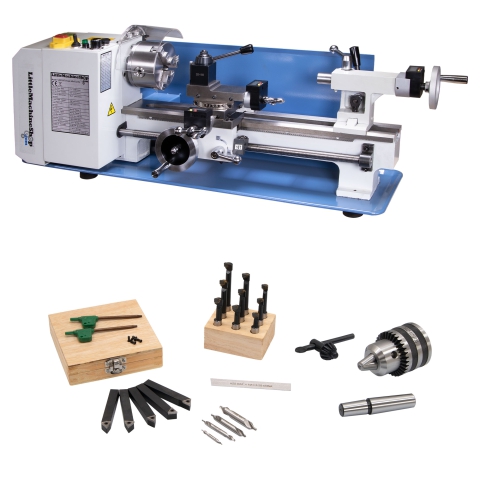

HiTorque Deluxe Mini Lathe with LED display and tooling package.
This package includes the newest HiTorque mini lathe, model 7350, and the 5124 tooling package.
The 7350 Deluxe mini lathe comes equipped with digital readouts on the cross slide, compound rest, and tailstock quill. The attractive hand wheels are all metal, and the levers are chrome.
A 500-Watt brushless spindle drive motor and belt drive provides tremendous power and low-end torque. There are NO gears to shift, so no gears to break. The drive allows for spindle speeds from 100 to 2500 RPM continuously in both directions. NSK brand Japanese-quality spindle bearings ensure smooth and quiet operation.
Standard on the lathe is an all steel, wedge-type quick change tool post which accepts turning tools up to 1/2" shank. Five toolholders are also included for the most common tools and tasks. The lathe also comes with a 4" Sanou lathe chuck, a Morse taper #2 dead center for the tailstock, and an 11-gear change gear set that includes a 21-tooth gear for accurate metric threading. For more details, see the Contents tab.
Real top and bottom half-nuts with a 16 TPI lead screw and a factory-installed threading dial provide extended threading capability. You can create every American Standard Unified class 2A inch screw thread from 4 to 80 threads per inch, and you can create every American Standard Metric class 6h thread from 0.3 to 8 mm pitch with the extra 21 tooth change gear that is included.
The 7x16 lathe includes attractive aluminum hand wheels and chrome levers. A backsplash guard and deluxe chip tray with rubber feet give a broader and more secure stance.
The 5124 tooling package comes equipped with a 2MT short arbor for the tailstock, a boring bar set, center drills, cut-off blade, 1/2" drill chuck and a set of turning tools with indexable inserts.

  • Mini Lathe Users Guide written by Chris Wood
  • Digital readouts on the compound rest, cross slide, and tailstock quill
  • NSK brand Japanese bearings
  • No gears in spindle drive
  • Metal hand wheels
  • Chrome levers
  • E-stop safety power switch
  • Extended threading capability - inch and metric threads
  • Rear apron shield to keep swarf out of the mechanism
  • Cam lock tailstock with DRO
  • 0XA wedge-type Quick change tool post set with five tool holders
  • Reversible lead screw for right and left hand threads
  • 4" 3-jaw chuck
  • Threading dial
Swing Over Bed 7.1" (180 mm)
Swing Over Saddle 4.3" (110 mm)
Distance Between Centers 16" (410 mm)
Cross Slide Travel 2.6" (65 mm)
Spindle Through Hole 0.8" (20 mm)
Spindle Taper #3 Morse taper
Tailstock Taper #2 Morse taper
Range of Threads 4-80 TPI; 0.35-8.0 mm
Spindle Motor Output 0.67 hp (500 Watts)
Spindle Speed 60 - 2500 RPM
Machine Weight 90 lbs (41 kg)
Crated Weight 114 lbs (52 kg)
Overall Dimensions (W x D x H) 31" x 10" x 12" (790 mm x 260 mm x 300 mm)
Crate Dimensions (W x D x H) 35" x 16" x 15" (900 mm x 410 mm x 380 mm)
HiTorque 7x16 Deluxe Mini Lathe - DRO on Compound and Cross Slide DRO on Compound and Cross Slide
HiTorque 7x16 Deluxe Mini Lathe - DRO Display DRO Display
HiTorque 7x16 Deluxe Mini Lathe - Control Panel Control Panel
HiTorque 7x16 Deluxe Mini Lathe - Control Panel and Chuck Control Panel and and 3-Jaw Lathe Chuck - (CHUCK GUARD HAS NOW BEEN REMOVED)
HiTorque 7x16 Deluxe Mini Lathe - Cam Lock Tailstock Cam Lock Tailstock
