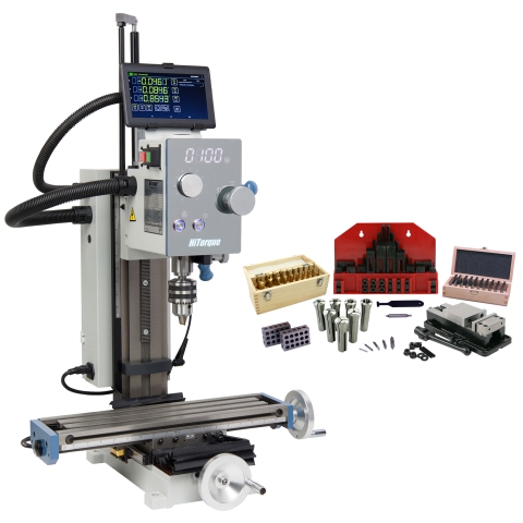

The mill in this package is the HiTorque model 6450. The mill has the standard HiTorque features including solid column, brushless motor and NSK branded bearings. In addition, this mills has:
- 3-axis digital readout (DRO) with Bluetooth and 7" tablet display.
- Electrically interlocked spindle lock.
- Machined aluminum handwheels and Z-Axis drill handles.
- New easy-to-read LED display with built-in spindle speed readout.
The 3-axis tablet display DRO connected via Bluetooth to magnetic scales on the table and column. The DRO system provides measures for the X, Y, and Z-axis in increments .0002" and comes factory installed on the mill.
The 500 Watt brushless spindle drive motor provides tremendous low-end torque. And you can vary the speed from 50 rpm to 2500 rpm continuously. There are no gears to shift. And, with no gears, the HiTorque Mini Mill is quieter than other mills in its class. NSK brand spindle bearings ensure smooth and quiet operation.
An electrically interlocked spindle lock ensures easy and safe operation. This mechanism makes tool changes easier, faster and safer. When engaged, the plunger automatically drops into the locking hole as the spindle is rotated. An electromagnetic interlock disables power to the motor, locking the spindle.
The large mill table provides 50% more table area than other mini mills. It also has 30% more travel in each direction. The re-settable feed dials allow you to zero them at any point.
This mill has a solid dovetail column (it does not tilt side to side). This construction is significantly stiffer than the tilting column on other mini mills. This model also includes an air spring head support for even movement through the Z-axis range of travel. The drill press handles are for drilling and fast motion of the mill's head. It also has Z-axis fine feed with 0.001" resolution for milling operations.
This machine is shipped completely assembled and adjusted. Machined surfaces are coated with a viscous oil to prevent rust. It wipes off easily with a rag; no solvents necessary.
The tooling package has all the essentials for basic mini mill operations and is bundled to work with the 6450 R8 mini mill.

The solid column is much more rigid than the tilting column.
Some people may feel that the tilting column is a feature, but I have used a mini mill for many years and never tilted the column on purpose.
Let's compare the LittleMachineShop.com Solid Column HiTorque Mini Mill to mini mills with a tilting column.
The tilting column on other folk's mini mills tilts 45 degrees from side to side. This has several advantages. First, it is possible to make some angled cuts. It's also easy to tram in the X-axis. One user (and only one) has described to me a cut that was impossible to make any way but using a tilting column.
This mill has a solid column. While it is harder to tram in the X-axis because you must use shims, it is not as easy to knock it out of tram as the tilting column mini mill. The solid column has thicker walls than the tilting column, and a stiffer joint where it joins the base, so the column is significantly more rigid than the tilting column.
LittleMachineShop.com no longer sells mills with a tilting column. That is an indication of how much better the solid column is.

  • LED display with illuminated controls and integrated spindle speed readout
  • Factory installed 3-Axis DRO with 7" Android tablet readout
  • Electrically interlocked spindle lock
  • Large X-Y table with attractive anodized handwheels
  • R8 Spindle for wide tool availability
  • Solid column that does not tilt
  • NSK brand Japanese bearings
  • No gears in spindle drive
  • Gas strut provides even support through the Z-axis range
  • Dovetail column maintains head alignment at any height
  • Fine feed on Z-axis for precise control
  • Three radial handles for drilling
  • E-stop safety power switch
  • Adjustable Z-axis stop for repetitive drilling
  • Neoprene bellows protect horizontal ways
  • Adjustable gibs on all dovetail ways
  • Includes R8 to 33JT drill chuck arbor and 1/2" drill chuck
  • Mini Mill Users Guide
