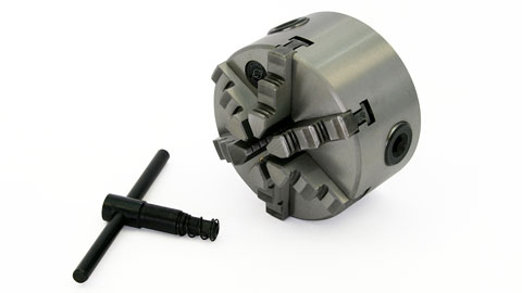

Lathe Chuck - 4", 6-Jaw, Self-Centering 2276  (Discontinued)
  • 6-jaw self centering lathe chuck
  • 4" (100 mm) diameter
  • Includes chuck key and mounting bolts
  • Plain back mounting
  • Excellent for holding thin walled workpieces
Part Number: 2276  (Discontinued)
Weight: 6.40 lb
Price: $299.95
PayPal Credit
The jaws on this 4" 6-Jaw self-centering lathe chuck are hardened and ground.
Includes chuck key and mounting bolts.
Because the chuck is designed to hold tubing, outside jaws are not included.
This chuck has a 1.02" (26 mm) through hole. The chuck can hold work up to 3.15" (80 mm) in diameter.
The radial runout of a test bar held in this chuck, when the chuck is mounted true, is 0.003" maximum.
Some people want a chuck that can hold larger diameters. 4" chucks work well on the mini lathe, but it is possible to use a 5" chuck on the mini lathe.
Mount this chuck on a mini lathe with one of our chuck adapters. Or purchase a chuck with an adapter already mounted.

Rated Capacity, Inside Jaws 0.24" - 1.18" (6.0 mm - 30.0 mm)
Rated Capacity, Jamming Range 1.18" - 3.54" (30.0 mm - 90.0 mm)
Rated Capacity, Outside Jaws 1.18" - 3.54" (30.0 mm - 90.0 mm)
Runout (Max) ≤ 0.003" (0.08 mm)
Diameter, Overall 3.94" (100.0 mm)
Registration Recess Diameter 2.83" (72.0 mm)
Registration Recess Depth 0.14" (3.5 mm)
Bolt Circle Diameter 3.31" (84.0 mm)
Center Hole Diameter 1.02" (26.0 mm)
Height 2.13" (54.0 mm)
Jaw Height Above Face 0.79" (20.0 mm)
Height with Jaws 2.91" (74.0 mm)
Number and Size of Bolts 3 M8
Chuck Key 0.31" (8.0 mm)
Chuck Designation K13-100
This product works with lathes with a 100 mm flange chuck mount including:
