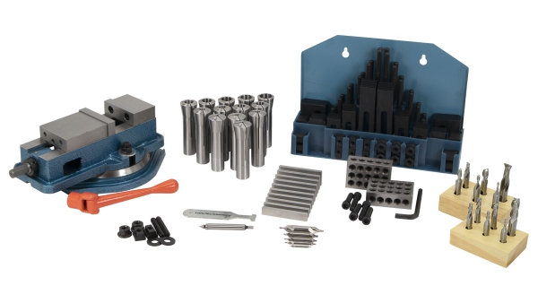

  • 3" Milling vise and 10 pairs of 3" long, high grade, thin parallels
  • Thirteen piece R8 collets, 20 piece End Mill Set - 2 and 4 Flute (10 each)
  • 58 - piece clamping kit - 3/8"-16, 7/16" T-slots
  • Premium precision 1-2-3 blocks, five center drills - 60 degree countersinks
  • Combination edge and center finder and a T-slot cleaner
Part Number: 4858
Weight: 56.7 lb
$719.95 Value Price
Purchased individually $732.95
Premium mini mill R8 tooling package with all the best products for your machine.
Precision Milling Machine Vise: 3" Kurt-style milling vice with detachable 360° swivel base and easy to read divisions. Top, gib, jaws, swivel base, bottom of vise bed and all plate mounting surfaces are ground. The angle tight positive lock style jaws are interchangeable with industry standard machine vises, are hardened and ground, and can be mounted on either end of the fixed and movable jaw supports for a wide range of clamping distances.
Overall length is 10.85" and the height is 3.05" without base, and 4.21" with base. Jaws are 3.15" wide, 0.94" deep, open 3", and are perpendicular to the ways within 0.002" in 4". The ways are parallel to the base within 0.0006" in 4" without the swivel.
Set of eleven pairs of thin parallels Parallels are 1/8" thick and 3" long
Heights are 1/2", 9/16", 5/8", 11/16", 3/4", 13/16", 7/8", 15/16", 1" Two pairs of shims are 9/64" and 5/32" Made of high grade alloy steel hardened to 52 to 58 Rc
End Mills: 20-piece End Mill Set - 2 and 4 Flute (10 each).
R8 Collets: 13 R8 round collets sizes 1/8" to 1" by 16ths. Made of high-grade tool steel, hardened and ground to a TIR of 0.0005" or less. This set includes all the sizes required for common end mills.
1-2-3 Blocks: Premium precision 1-2-3 blocks, ground and case hardened on all sides to 55-60 Rc. Blocks are 1" x 2" x 3"; parallel, flat, and square within 0.0001". Mini mill tooling package set includes two matched blocks and 5 cap screws. Blocks have 23 holes, five are threaded 3/8"-16 NC.
Center Drills: Five-piece M42 8% cobalt combined drills and countersinks sizes 1, 2, 3, 4, and 5 with 60-degree counter sinks.
T-slot cleaners are designed for Bridgeport mills. It takes a few seconds on a grinder to reduce the size of the "T" to fit the slots on the mini mill.This is our premium vise for the mini mill. It is considerably heavier and therefore more rigid than our next biggest vise.
Combined drills and countersinks, commonly called center drills, are used to produce a center hole on a workpiece for turning between centers. Center drills are also used to start drilled holes. Because they are very stiff they don't have a tendency to wander.
