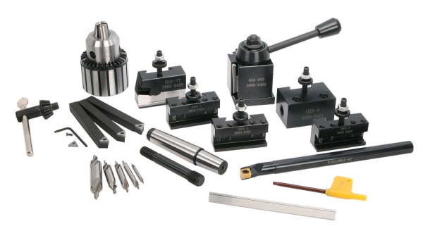

  • 0XA QCTP set with post mount for SC4 lathes
  • 1/2" professional grade drill chuck, 2MT standard to 33JT drill chuck arbor
  • 1/2" indexable boring bar - CCMT inserts
  • 3/8" indexable TCMT carbine inserts
  • Premium P1 cut-off blade, 5 center drills
Part Number: 4857

Includes a 0XA (Series 000) quick change tool post set (QCTP).
This set includes the tool post and the following tool holders:
2 - #1 Turning and Facing
1 - #2 Boring, Turning and Facing
1 - #4 Heavy Duty Boring will hold both 3/8 and 1/2 boring bars
1 - #7 Universal Parting Blade (for 1/2 inch cut-off blade - horizontal)
QCTP features all steel construction and wedge type tool post for better clamping and repeatability. All working parts are hardened, ground and sealed. Designed for lathes with limited distance from the top of the compound to the center of the lathe. This tool post mounts with an M12/M10 stud for C4 and SC4 lathes, which is included.
The 1/2" capacity professional grade drill chuck is mounted on a short 2MT shank for the mini lathe. Specifically designed for the mini lathe tailstock, the rated capacity is 1 mm (0.039") to 13 mm (0.512"). All working parts are hardened. Chuck key included. Number 33 Jacobs taper mount. This chuck is comparable to a Jacobs 34-33 heavy duty drill chuck, including the runout specification of 0.004" (0.10 mm) or less.
Indexable turning tools are made by Arthur R. Warner Co. in the USA. These precision tool holder kits use carbide inserts and include three styles of tools, AR right hand, E Neutral (threading tool - 60 degree angle), and AL left hand. Kit includes three tool holders, TCMT inserts, one extra TCMT-21.52 carbide insert, one extra Torx screw, and one wrench.
1/2" diameter indexable boring bar uses CCMT inserts and is 7" long. The minimum bore diameter for this is 0.625". The boring bar takes CCMT 32.51 or CCMT 32.52 inserts.
The premium P1 parting blade is 1/16" x 1/2" x 4-1/2" and made from M2 HSS by Arthur R. Warner Co. T-shape parting blades provide great side clearance.
Five sizes combined drills and countersinks made of high speed steel. Sizes 1, 2, 3, 4, and 5 with 60 degree countersinks.
